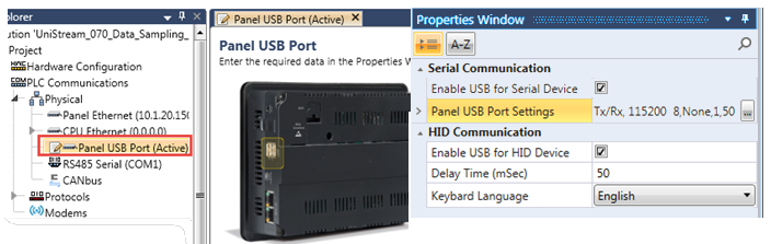

Starting from UniLogic version 1.23.25 (Bin_Files 1.23.8) you can connect to the USB host port devices such as scanners that can be configured as HID.
In case you wish to connect external keyboard (English & French supported) and type directly to a text box without using the virtual keyboard - you can use the HID feature:
