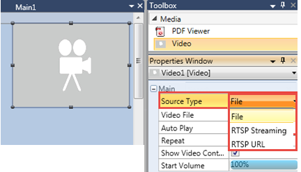

Stream video from a camera via the RTSP Protocol:
After placing the widget on the display, select the Source Type; the Properties change to reflect your choice:
Properties - RTSP Streaming
Source IP
These are the camera's settings.
Source Unique Name
Source Password
If a password has been assigned to the camera, you must supply it.
Source Port
The default port for RSTP is 554.
Show Video Controls
When this is checked, the video player displays controls that enable the user to start, stop, and adjust the video volume.
Start Volume
Move the slider to set the volume level when the file is opened.

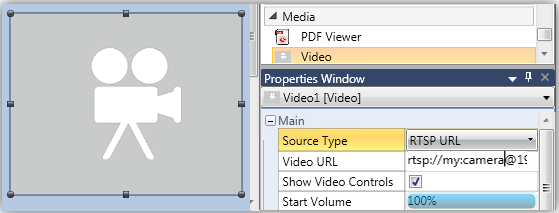

Properties - RTSP URL
Video URL
Enter the parameters according to your requirements.
Show Video Controls
Start Volume
