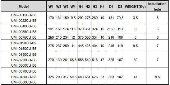

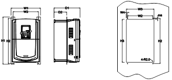

Wall installation of UMI-B5 3PH 220V 1.5~15kW and 3PH 460V 1.5~30kW inverters

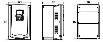

Wall installation of UMI-B5 3PH 220V 18.5~55kW and 3PH 460V 37~110kW inverters

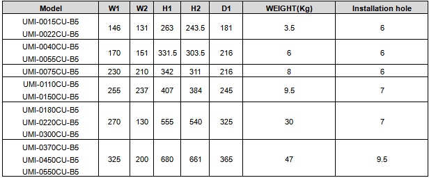

Wall installation dimensions of UMI-B5 3PH 220V 1.5~55kW (unit: mm)

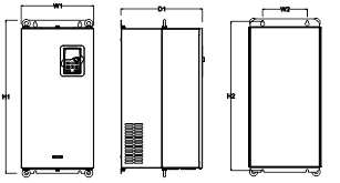

Wall installation dimensions of UMI-B5 3PH 460V 1.5~110kW (unit: mm)

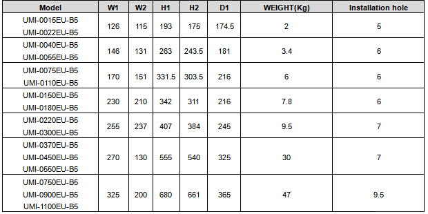

UMI-B5 Flange installation
Flange installation of UMI-B5 3PH 220V 1.5~15kW and 3PH 460V 1.5~30kW inverters
Flange installation of UMI-B5 3PH 220V 18.5~55kW and 3PH 460V 37~110kW inverters
Flange installation dimensions of UMI-B5 3PH 220V 1.5~55kW (unit: mm)
Flange installation dimensions of UMI-B5 3PH 460V 1.5~110kW (unit: mm)
