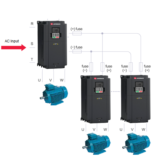

Unitronics B1 VFD's having rated power capacity above ≥ 4kW and all B5 series supports DC Bus power sharing.
One have to be connected to the grid and the others can be connected to the shared DC bus only.
