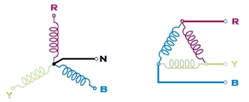

Motor Wiring
There are 2 wiring options; the wiring is determined by the grid voltage. The motor voltage should be ≤ Grid voltage (See Image 2).
Star: Connect the starting or finishing ends of three coils together to form the neutral point. A common wire, Neutral is taken out from the neutral point.
Delta: Delta winding allows third-harmonic currents to circulate within the transformer, and prevents third-harmonic currents from flowing in the supply line. Delta connected windings are not commonly used for higher transmission voltages (138 kV & above).

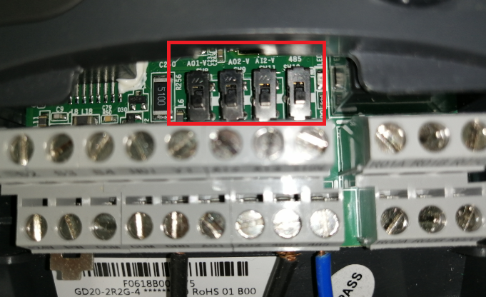

  • Make sure that the last communication loop VFD 120OHM termination is on (right DIP switch or jumper is UP) and for all the other VFD's are off (right DIP switch or jumper is DOWN), as additional check measure the resistance between the 485+ and 485- terminals on the PLC and make sure that the value is 60OHM.

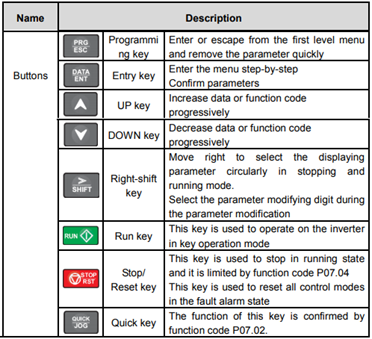

The following image shows you how to use the VFD Keypad.

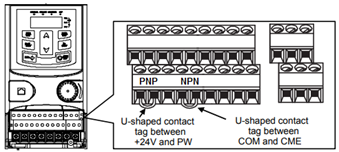

Terminal
In case you wish to send commands to the VFD via the terminal (IO) connect the PLC digital outputs to the VFD digital inputs (S1-4).
Note- the connection can be wired as Source or Sink (default).
Use a U-shaped contact tag to set NPN or PNP mode, and the internal or external power supply. The default setting is NPN internal mode.
                           Image 3 *
Image3 example for UMI-B1 UL Series.

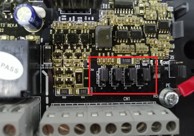

Terminal Dip switches
Above 2.2KW:
Below 2.2KW:
