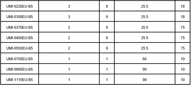

In this document you will find all relevant information regarding cable gauge and required wire torque in terminals.
  • All analog control cables and the cable used for the frequency input must be shielded.
  • Use at least 75C(167 F) copper wire.
  • Control cables recommended tightening torque is 0.5Nm (4.5 lbs-in).
  • Required wire torque, type and range for field input and output terminals listed below:
