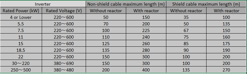

Cable length between VFD and motor
AA
Nov-19th, 2018 11:05
This table indicates the maximum cable distance between the VFD and the motor, dependent if the cable is shielded or not.
