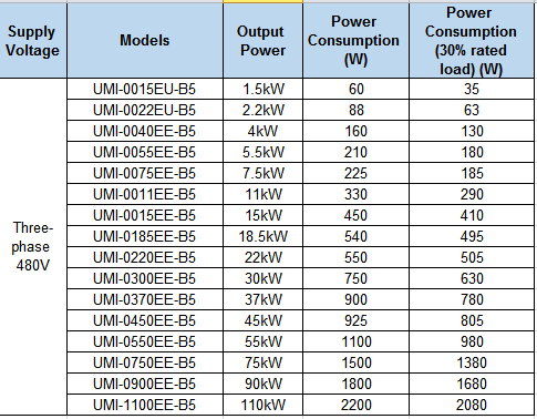

UMI (Unitronics VFD) Heat Dissipation
OL
Oct-16th, 2018 9:55
UMI-B1 Series Heat Dissipation
UMI-B5 Series Heat Dissipation
