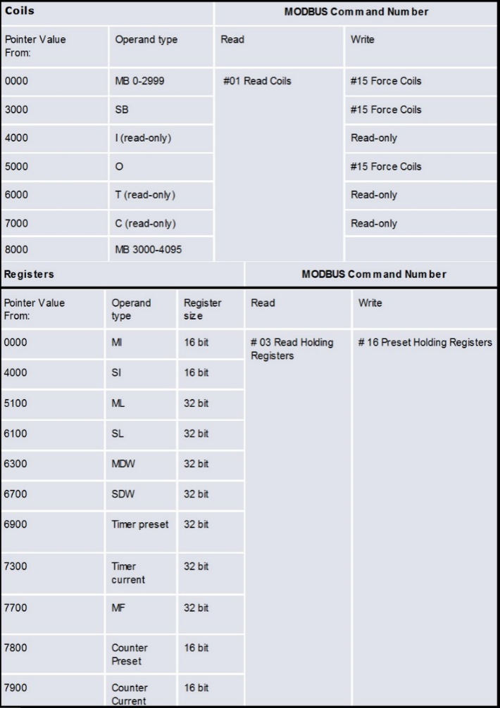

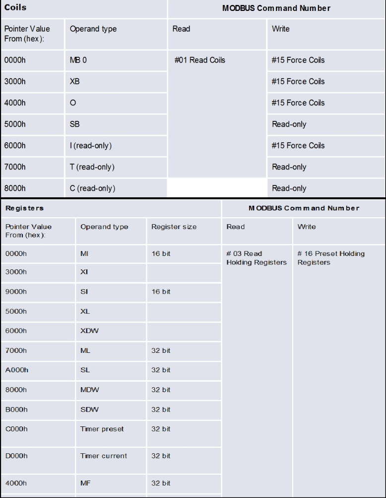

Within a MODBUS network, you can use standard MODBUS commands to read and write bit and register data; you can also read and write data to Vision controller Data Tables.
Vision PLCs can be configure as either Modbus client -Master- or Modbus -Slave-. it can even be configure as a master slave with the use of two serial ports or two Ethernet Sockets.
Vision enhanced Slave addressing (hexadecimal)
Standart Vision Slave addressing (Decimal)
