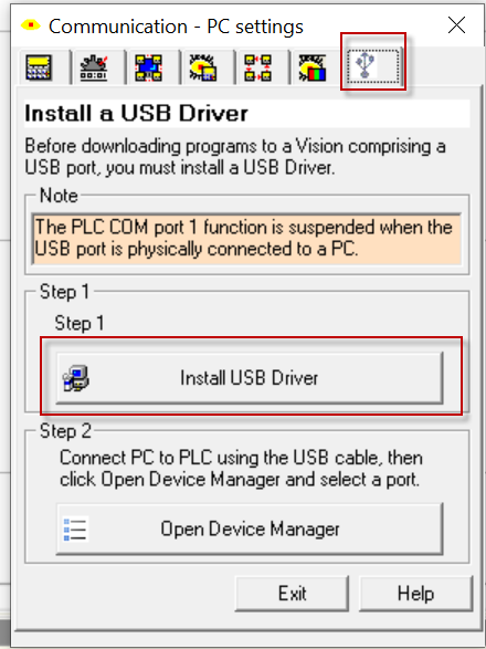

5. In the Visilogic software start by opening a blank program or project. Configure the HW configurator to the PLC model you have. Go ahead and select the Connection tab on the top ribbon and select the last option named Communication & OS.
6. Select the right most icon on the top, looks like a USB icon to Install the USB driver.

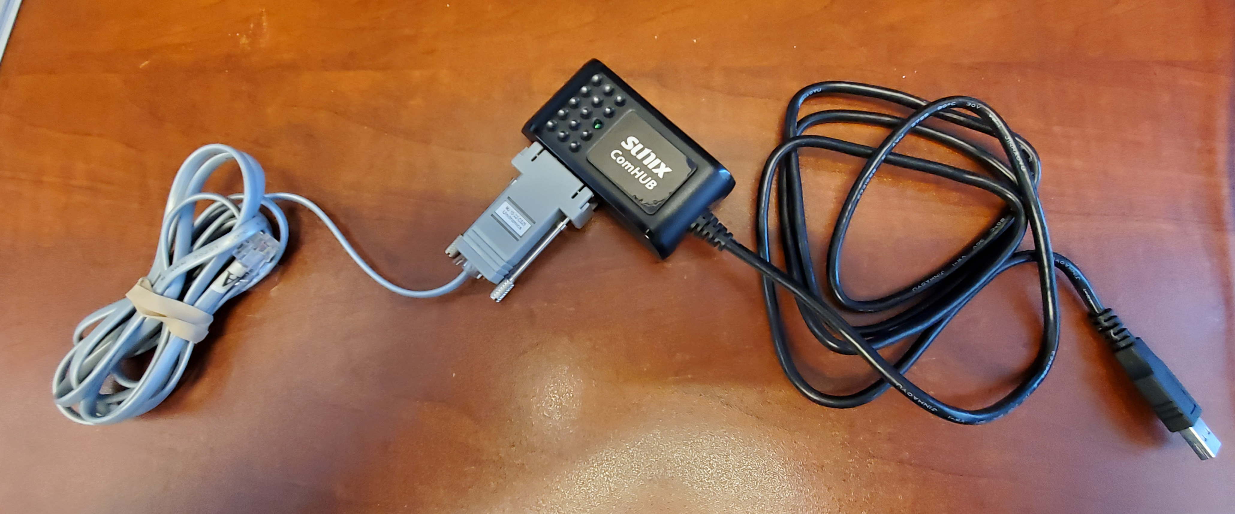

7. Shown below is how you will connect from using a USB to rj11 to communicate to the V350 from your PC. The black cable is the USB to DB9 male connector that you have and the grey cable the rj11 to MJ10-22-CS25 DB9 female connector that I am sending to you. Connect the rj11 to the V350 and the USB connector to you PC before selecting step 1 mentioned in step 8 below.
8. Select step one to Install the Driver. An Installation wizard will appear and prompt you to select next to download a Silicon Labs driver that will work with the software to the PLC to communicate.
9. Select step 2 to open the Device manager on your PC. Connect the cable(s) to the PLC and then the PC. You will see a PORTS folder appear once the cable(s) are connected. Open the folder and note what COM # your USB or DB9 connector is using on your PC.
