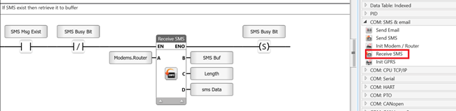

Receipt of SMS:
When the SMS Queue is full, you can retrieve the message from the Router's Struct.
B- The Buffer that gets the message
C- The length of the message received
D-Struct of the SMS Metadata type that receives:
From the related Struct you can get the number that sent the message, and the time it happened.
