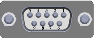

Wiring:
  1. UCR-B8 RS232 Connector Pinout
PIN
NAME*
DESCRIPTION*
1
DCD
Data Carrier Detect
2
RXD
Receive Data
3
TXD
Transmit Data
4
DTR
Data Terminal Ready
5
GND
Signal Ground
6
DSR
Data Set Ready
7
RTS
Ready To Send
8
CTS
Clear To Send
9
RI
Ring Indicator
