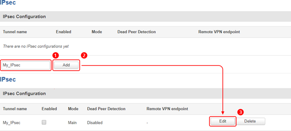

IPsec
Next, you must configure a working IPsec Transport connection. This subsection contains instructions on how to do just that. Other used parameters will be defaults; you can find explanations for those parameters in the manual page.
  • Go to the Services → VPN → IPsec page and do the following:
  1. Enter a custom name for the IPsec instance.
  2. Click the Add button.
  3. Click the Edit button next to the newly created instance.
  • In the IPsec Configuration page, do the following (and leave the rest as defaults, unless your specific configuration requires otherwise):
  1. Enable the instance.
  2. Select Type: Transport and save changes.
  • After having saved the changes, you will be redirected back to the main IPsec page. While there, locate the Pre-shared Keys section and do the following:
  1. Click the Add button.
  2. Enter your Pre-shared key.
  3. Enter %any under Secret's ID selector.
  4. Click the Save button.
