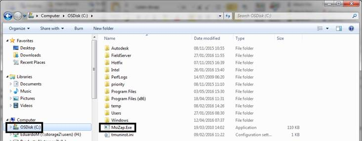

  • Using the attached MsiZap Download the attached file named "MsiZap.zip"
    Unzip it and copy the "MSIZap.exe" file to C: \ drive

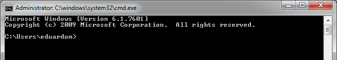

      • Run the command line ("cmd") as administrator

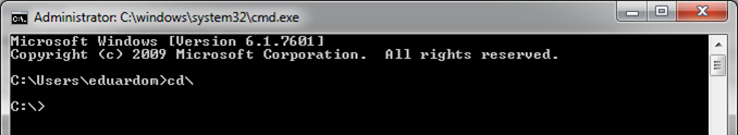

      • Type the command "cd \" to get to the root directory C:\

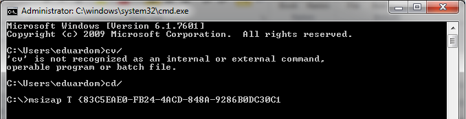

      • Copy/paste and run the following command: "msizap T {83C5EAE0-FB24-4ACD-848A-9286B0DC30C1}"
      • Copy/paste and run the following command: "msizap TWA! {83C5EAE0-FB24-4ACD-848A-9286B0DC30C1}"
