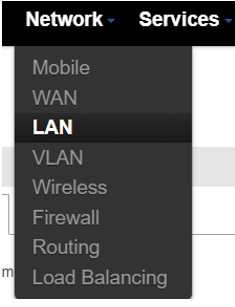

These steps will demonstrate how to configure port WAN into LAN on UCR devices:
1)  Go to Network >>LAN

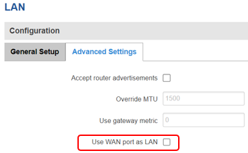

    2) Press on advanced settings:
    **Pay attention that if you WAN connection (Operation mode is determande to wired it won’t let you change the WAN port to LAN**
    Suppose to be configured for mobile or WIFI

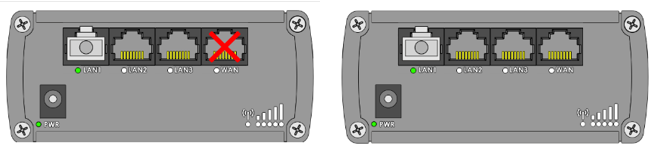

    You can check on status>> Network>> WAN & LAN that port WAN has been changed
