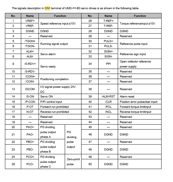

In order to do so you will need to wire CN1 IO connector.
CN1 pin 14 is the "Servo On" input, Connect +24Vdc to pin 13 and relay output to Pin 14.
CN1 pin 26&27 are the Torque value input
CN1 pin 1&2 are the velocity speed input.
CN1 pin 9&10 are the Servo ready outputs.

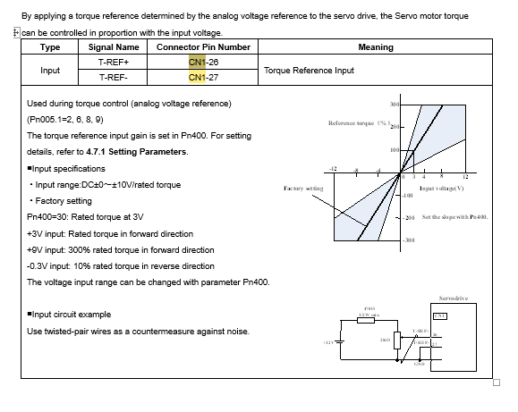

Torque Control:
  1. Please note PN006 (No Bus) must be set to 0.
  2. Restart the Servo after PN006 change.
  3. Set Pn005 to H.0020 (default value is H.0010)
  4. Change Pn400- Torque Reference Input Gain, 10-100 (default value 33)
  5. This value will set the minimum Torque per 0.1V/100% due to the equation:
  6. VRef [0.1V]x Pn400.
  7. This value can be changed during Servo RUN operation.
For example:
Pn400=30: The Servo motor operates at the rated torque with 3V input (factory setting).
Pn400=100: The Servo motor operates at the rated torque with 10V input.
In order to apply 300% Torque, set Pn400=30 and VRef=9V
  • Connect Analog reference to CN1 pin 26 +Ref, Pin 27 –Ref. -10VDC - +10VDC
  • Check Un003 for the actual Torque.
  • The Servo will start RUN in Torque once S-ON is enabled.
