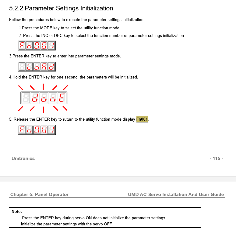

Reset Servo drive to factory default
AA
Jan-14th, 2020 6:32
The option to reset the servo drive to factory default is at :
FN001
