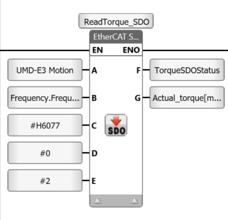

To read torque in Cyclic mode one can use EtherCAT SDO Read.
the SDO index of torque is H6007.
SDO Subindex is 0.
Number of bytes to read is 2.
