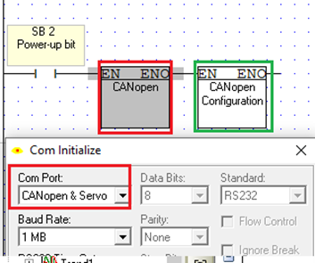

Setup Servo in VisiLogic:
1. Please make sure to download the latest VisiLogic and update the Vision OS for Servo:
2.  Add Com Init for CANopen & Servo:
3. Add CANopen Configuration and using right click on the node number select CANopen servo:

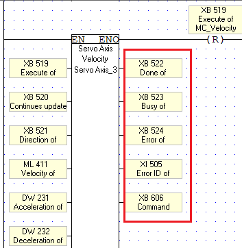

4. From the Function Blocks menu you can find the Servo FBs - Please note that all Servo MC block should be connected directly on the left line.
5. MC power FBs must be used in order to enable servo operation. Place the MC Power connected directly to the left line and fill all parameters and vectors.
5. Now can use any MC FB such as MC move, MC Home, etc..
6. For each MC FB fill the parameters and activate it using the execute bit - You can check the result of the MC FB using its outputs:
Please note that MC FBs are executed only on the rise of the execute bit.
Detailed information about each one of the MC FBs can be found in VisiLogic help file.
