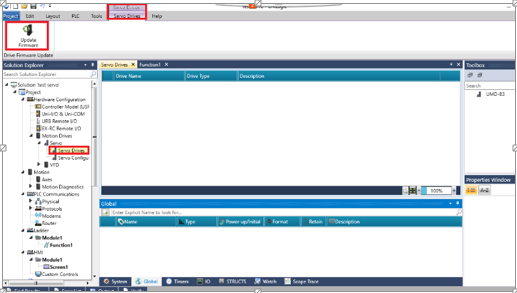

UniStream:
1. In the Solution explorer, select Hardware configuration Motion Drives Servo.
2. Highlight Servo Drives.
3. In the main menu, select Servo Drives.
4. Press Update Firmware.
5. Follow the instructions in the wizard.
6. After update the firmware it is recommended to Factory Reset the Drive in FN001.
The Drive display will show "LOAD".
Press on Enter for 3 seconds.
The Drive display will show "Done".

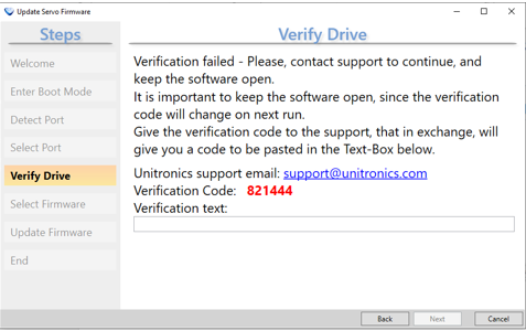

7. In case the update is failed and the pop up screen is appear, please contact Unitronics Support.

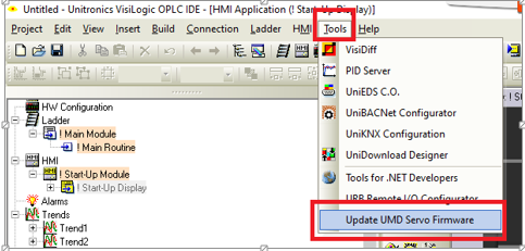

Visilogic:
VisiLogic:
1. From the Tools MenuàUpdate UMD Servo Firmware
2. Follow the instructions in the wizard.
