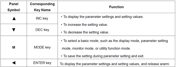

Panel Operator
The panel operator is a built-in operator that consists of display section and keys located on the front panel of the servo drive.
Parameters setting, status display and execution of utility function are enabled using the panel operator.
The names and functions of the keys of the panel operator as follow:
Servo alarms can be reset by pressing the ENTER key when the panel operator in display mode.

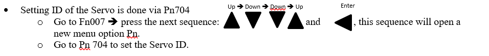

Servo ID
Note that this procedure is only for setting the Servo`s ID, changing the setting of something else might harm the Servo`s functionality
Set the Servo ID to a different ID than ID1. Baud Rate

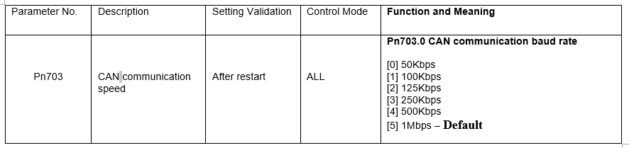

  • You change the baud rate of the communication to:
  • To change the baud rate, press a long press to the Enter button to enable editing, use the Up, Down buttons to change the index value.
