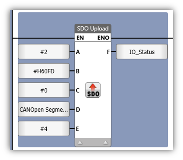

1) Identify the Activated Limit Switch
    • Use SDO Upload function to read address H60FD (hex), sub-index = 0 in the length of 4 bytes.
    • The first bit indicates NOT activation.
    • The second bit indicates POT activation.

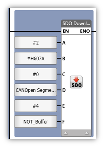

2) Send Recovery Position Command
  • Use SDO Download function to address H607A (hex) index 0, sub-index 4
  • For POT activation: Send value -88684080.
  • For NOT activation: Send value 88684080.
  • This will put the servo into Ready mode.
3) Move Away from Limit Switch
  • Once the limit switch is deactivated, use MC jog function to move the servo away from the limit position.
  • The servo will now respond to movement commands.

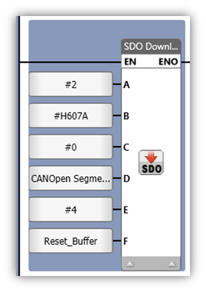

4) Reset Target Position
  • After clearing the switch condition, reset the target position.
  • Send SDO Download to address H607A (hex), sub-index 0, num of bytes = 4.
  • Set buffer value to 0.
  • This reactivates the POT/NOT functionality.
