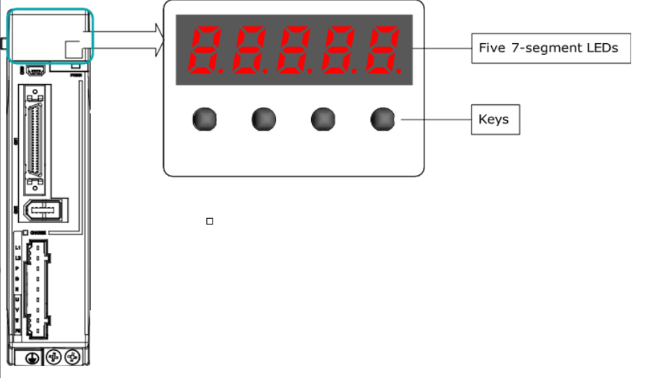

Panel Operator
There is a Panel Operator on the front of the Drive, as is shown in below pics of Panel Operator.
The names and functions of the keys on the Panel Operator are as follows.

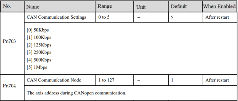

Set the drive to CANopen control (B5 drives)
Drive default control is set to Non bus setup Pn006.0=0, to set the drive to CANopen control set Pn006.0=1
  • set the drive CANopen baud rate to fit your application/master (Pn703)
  • Set the CANopen ID address via Pn704
Note: those parameters change will take effect only after drive power restart.
