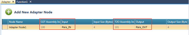

Attached is a template EDS file for UniStream as Ethernet/IP adapter.
The adapter addressing were defined as captured below:

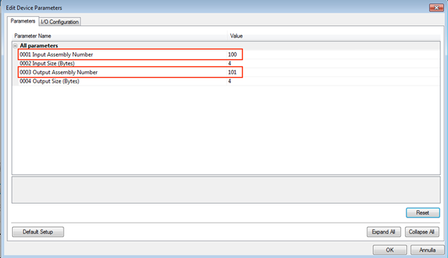

These data you have to put also of course in Network Configuration of Omron Ethernet IP settings:

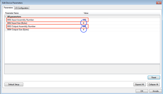

As well as the Input/Output size in bytes:

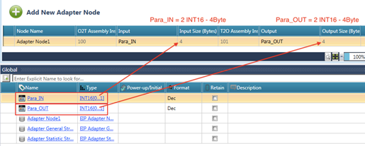

Based on the size of the array that you set in UniLogic:
And of course the same size of bytes has to be set in Omron Network configuration settings:
