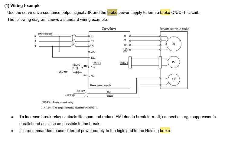

Or control the Brake via the Servo drive as follow:

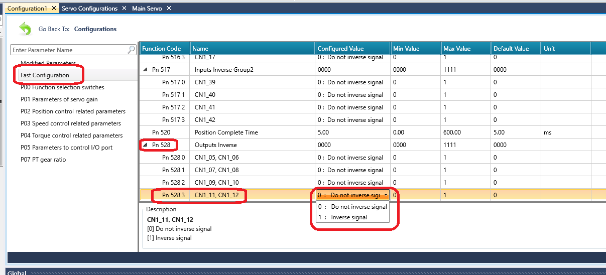

The default Servo output for the Brake is in CN1 11 and CN1 12, the connection to the Brake will be via Relay.
The option to work in npn or pnp is also available and the signal can be inverted as follow:
