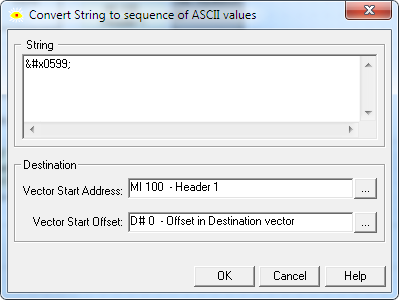

In your project you have to replace:
For
Replace  ֙ for ҙ
*It seems like your HTML variant.
In common, you can store strings in String Library as ASCII, and convert text in temporary buffer to UNICODE/HTML.
