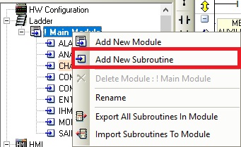

2.       Add a new subroutine and rename it to "_Interrupt HSC 0,1".

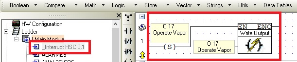

3.       Click on the "_Interrupt HSC 0,1".
4.       Add the logic to the interrupt routine. Here for example the interrupt will set output 17:
