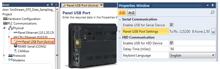

Starting from UniLogic version 1.23.25 (Bin_Files 1.23.8) you can connect to the USB host port devices such as scanners that can be configured as HID.
This way you can connect for example a Barcode scanner and the configuration & logic in UniLogic is the same as serial port.
  • Select Enable USB for HID device; modify Delay Time and Keyboard Language as required
  • A struct will be created and you can use its members to determine when you wish to extract the data to the buffer using COM RX ladder element:
