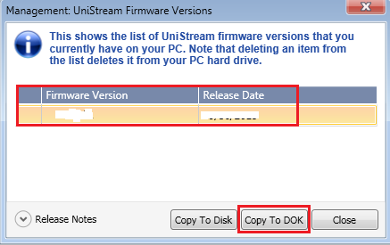

In UniLogic, Go to "PLC" menu > UniStream Management >Firmware Manager.
Choose the latest Bin version

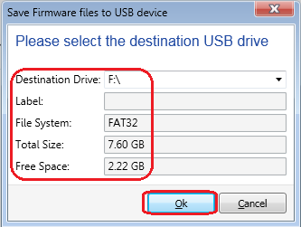

Insert a FAT32 formatted flash drive more than 2GB (Disk-On-Key) to your PC and click on "Copy To DOK" button.
When UniLogic recognize your DOK click OK to copy the latest Firmware
This process can take about 10-15 minutes.

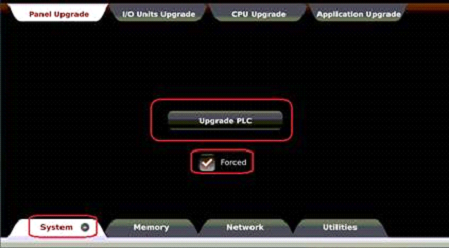

In UniStream Panel >UniApp (Touch and hold the upper right corner of the screen for few seconds)
Go to System >Upgrades > mark "Forced" >Upgrade PLC > Upgrade
This process can take 10 -20 minutes.
