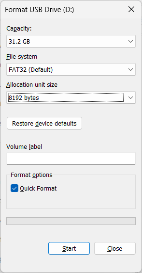

17. Format new disk from VM Windows File Explorer with cluster size 4096.
18. Enter "detail partition"
DISKPART> detail partition
Partition 1
Type : 0B
Hidden: No
Active: No
Offset in Bytes: 1048576
Volume ### Ltr Label Fs Type Size Status Info
* Volume 4 E FAT32 Removable 7579 MB Healthy
File system is FAT32

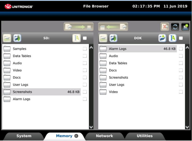

22. Insert SD/Disk on key to SAD slot or to USB connector at PLC.
23. Go to UniApps at PLC.
24. Select Memory->File Browser.
25. For SD card you can see list of default directories.
26. For Disk on key DOK you can see list of files or directories, if presented.
