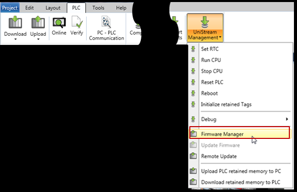

1.       Click UniStream Management> Firmware Manager.

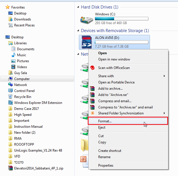

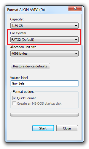

2.       Download Firmware  onto a DOK (Disk On Key, also called a USB Flash Drive or memory stick). Please note that the USB flash drive must be formatted as FAT32 before the files are copy to it. Please format the flash drive, using the Windows tool with FAT32 format.

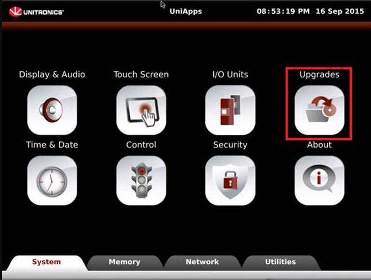

4.       Enter UniApps, select System> Panel Upgrade.

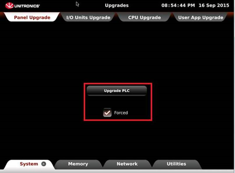

 5.       Select Forced.
6.       Press Upgrade PLC, and follow the on-screen directions. This will take about 10-20 minutes.
After Process has finished, reboot PLC.
