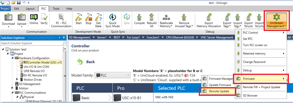

To do remote update of the BIN files►

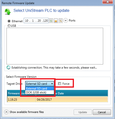

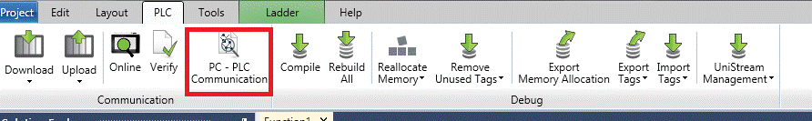

Please make sure you have connection to the UniStream either via USB or Ethernet cable. For this you can link on PC-PLC connection on the PLC menu.
Wait until UniLogic recognize the UniStream.
Once UniStream is recognize, go once more to UniStream management and select remote update option.
Insert a USB or SD card (FAT32 formatted) to the UniStream PLC slot and choose the correct target accordingly.
Please also select the option force.
Once connection has been establish, press the update button and wait for the PLC to be updated
Update process will start, unilogic will copy the files to the PLC choosen memory, and update process will start.
wait until it finished- the PLC will reboot automatically and start up with the new OS....
