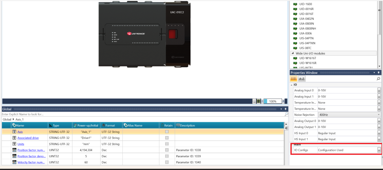

When IO model does to recognized in 1.33.373 you can fix the issue in the following:

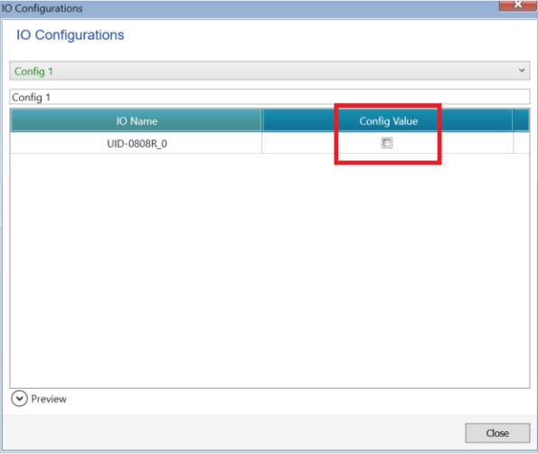

In UniLogic at IO config at the general position you can change the IO config

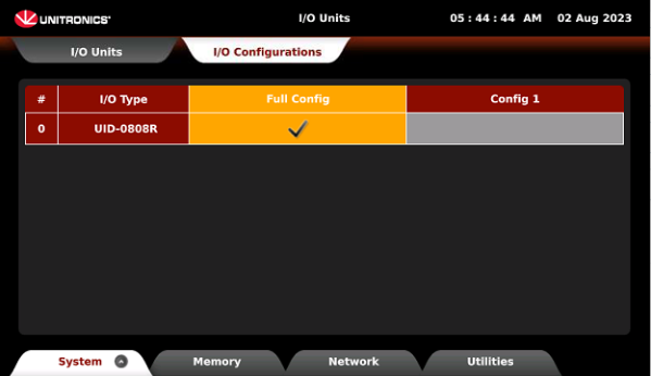

Under config 1 you need to disable the IO
after that in UniApps under IO you can change the config to config 1 reset and then set it back to normal.
