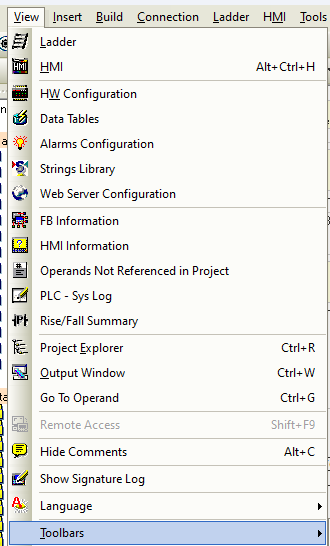

If one or more VisiLogic Menu options disappears, do next:
1. in Menu go to "View->Toolbars":

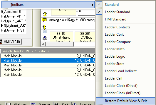

2. Select "Restore Default View & Exit":
3. Run VisiLogic again and check if menu option are presented.
