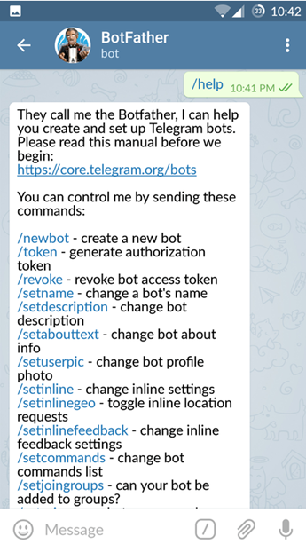

  • Step 1. In your Telegram app, start a dialog with a bot named "@botfarther." He will help you create and manage your bot.
  • Step 2. Print “/help” and you will see all the commands that the BotFather supports.

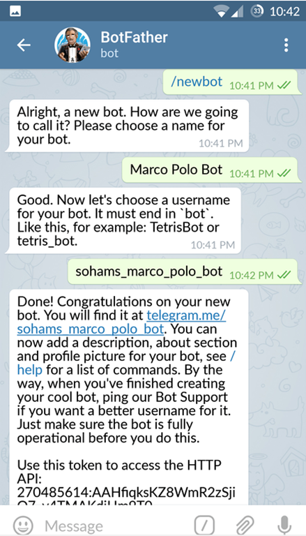

  • Step 3. To create a new bot, type “/newbot” or click on it.
Follow the instructions and create a new name for your bot. You will receive a newly generated API token.
