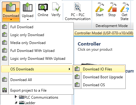

How to upgrade IO OS from UniLogic
Eden Nishri
Apr-14th, 2025 7:30
  1. Enter C:\ProgramData\Unitronics\UniLogic\Upgrade\IO_OS
  2. Create folder with the IO model you want to upgrade, using the following list
    For example, for UIS-04PTN create a folder with the name: PT4
    0,DI8RO8, UID-0808R
    1,DI8TO8, UID-0808T
    2,AI4AO2, UIA-0402N
    3,DI16, UID-1600
    4,DRO16, UID-0016R
    5,DTO16, UID-0016T
    6,DI8TO8HS, UID-0808THS
    7,PT4, UIS-04PTN
    8,TC8, UIS-08TC
    9,DI16RO16, UID-W1616R
    10,DI16TO16, UID-W1616T
    11,AI8, UIA-0800N
    12,CB1, UIS-WCB1
    13,AO6, UIA-0006
    14,CB2, UIS-WCB2
    15,PTK4, UIS-04PTKN
    16,AI8H, UIA-0800NH
    17,CB6, UIS-WCB6
  3. Put inside the folder the OS files (contact support for your specific required files).
  4. Open UniLogic and choose:

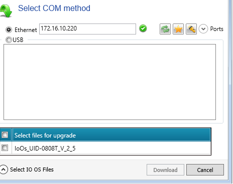

5. Select the PLC address and the correct IO OS from the list and follow the instructions:
