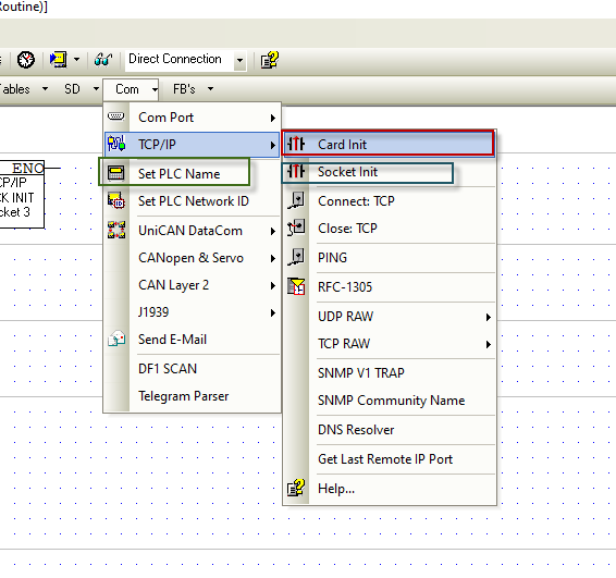

To download to the PLC form your PC using an ethernet connection please follow the steps below:
  1. The PLC must need to have or comprise an Ethernet card in one of the com ports on the controller.
  2. In the ladder code add the function TCP/IP card Init after a direct contact of SB2 and configure the IP address, Subnet mask and default gateway according to your network settings.
  3. The PLC Name, TCP/IP Card Init and TCP/IP Socket Init can be found under the Com tab when selecting Main Module under the ladder row in the solution explore field to the left of the software screen.
  4. Add the function PLC name after TCP/IP card Init and configure your PLC name.
5. Connect a TCP/IP Socket Init FB to the Card Init to setup the socket number you will use, protocol is set to TCP, local port depends on the socket number, # 0 is 20000, # 1 is 20256, # 2 is 502, and # 3 is 20257. Set the client/server to Server(slave).
