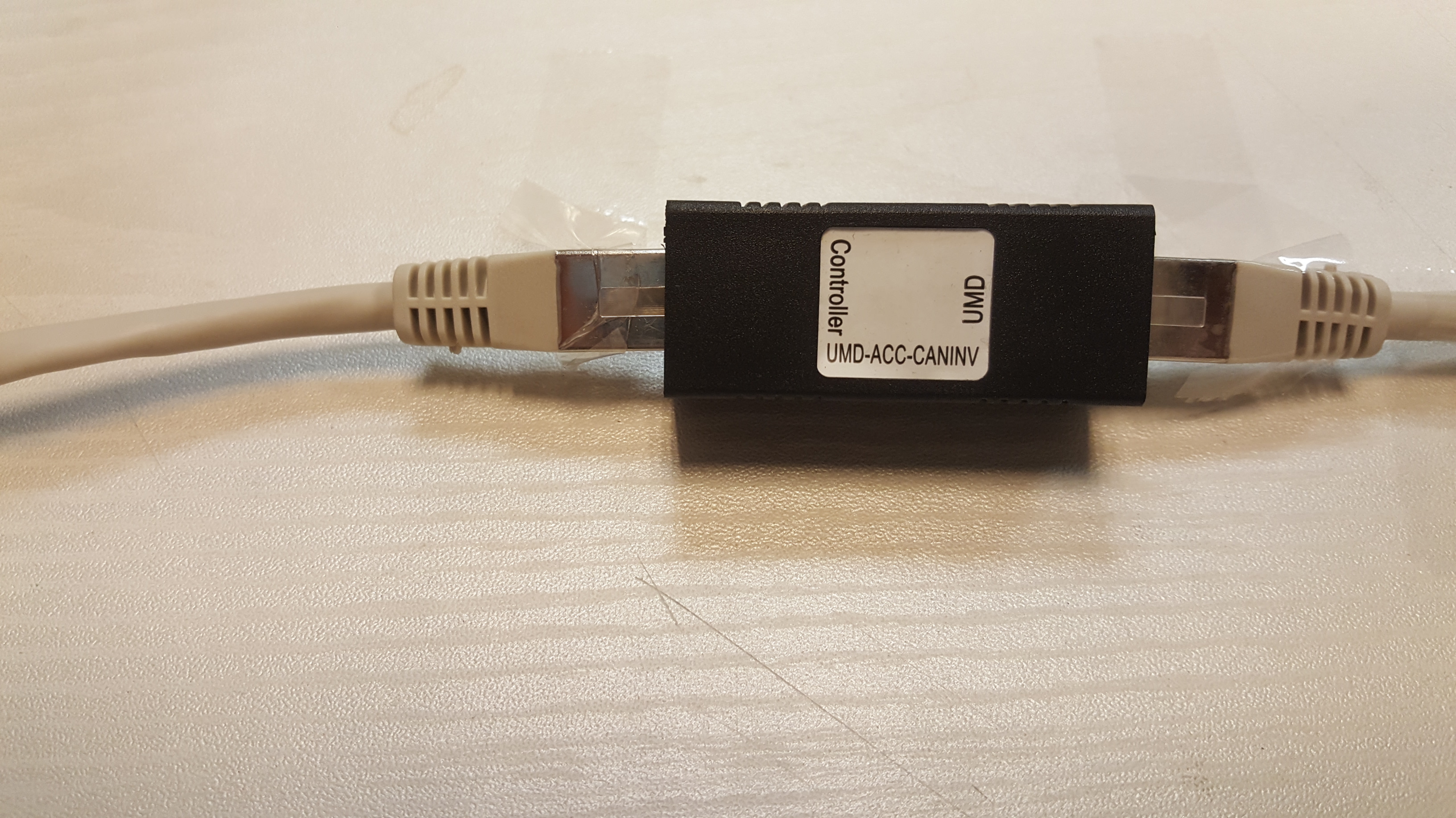

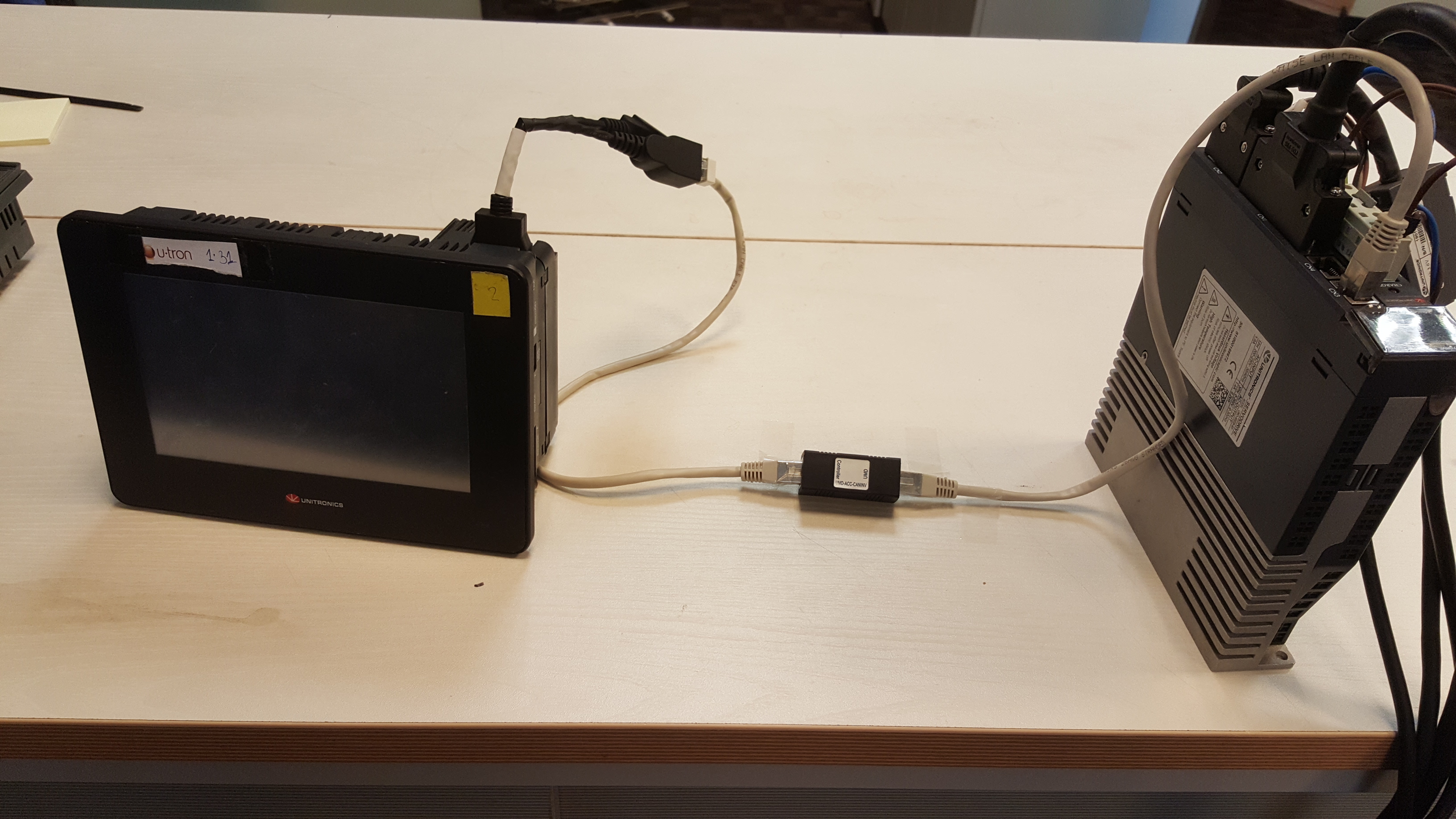

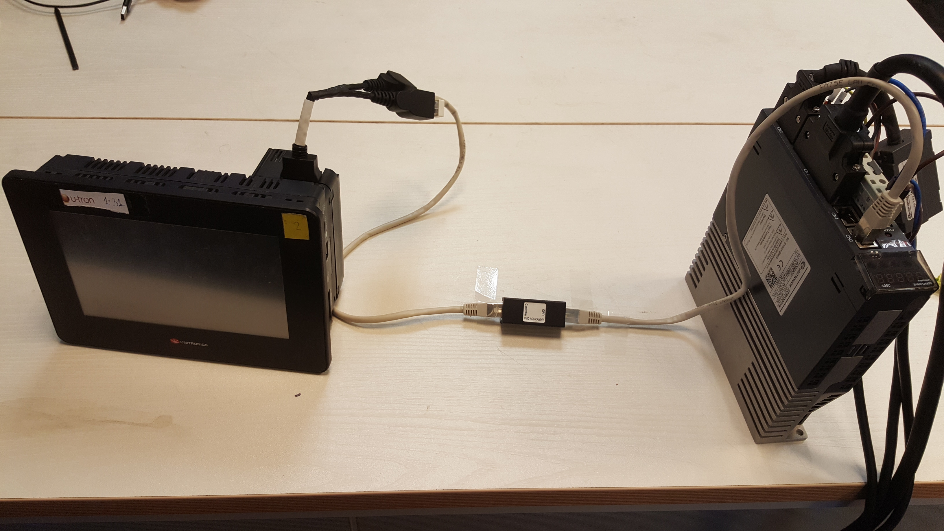

Unitronics recently added a UMA-CX-CANKit-A to wire beween a PLC and Servo drive.
The kit includes:
1. Canbus Y cable
2. LAN adapter
3. Resistor

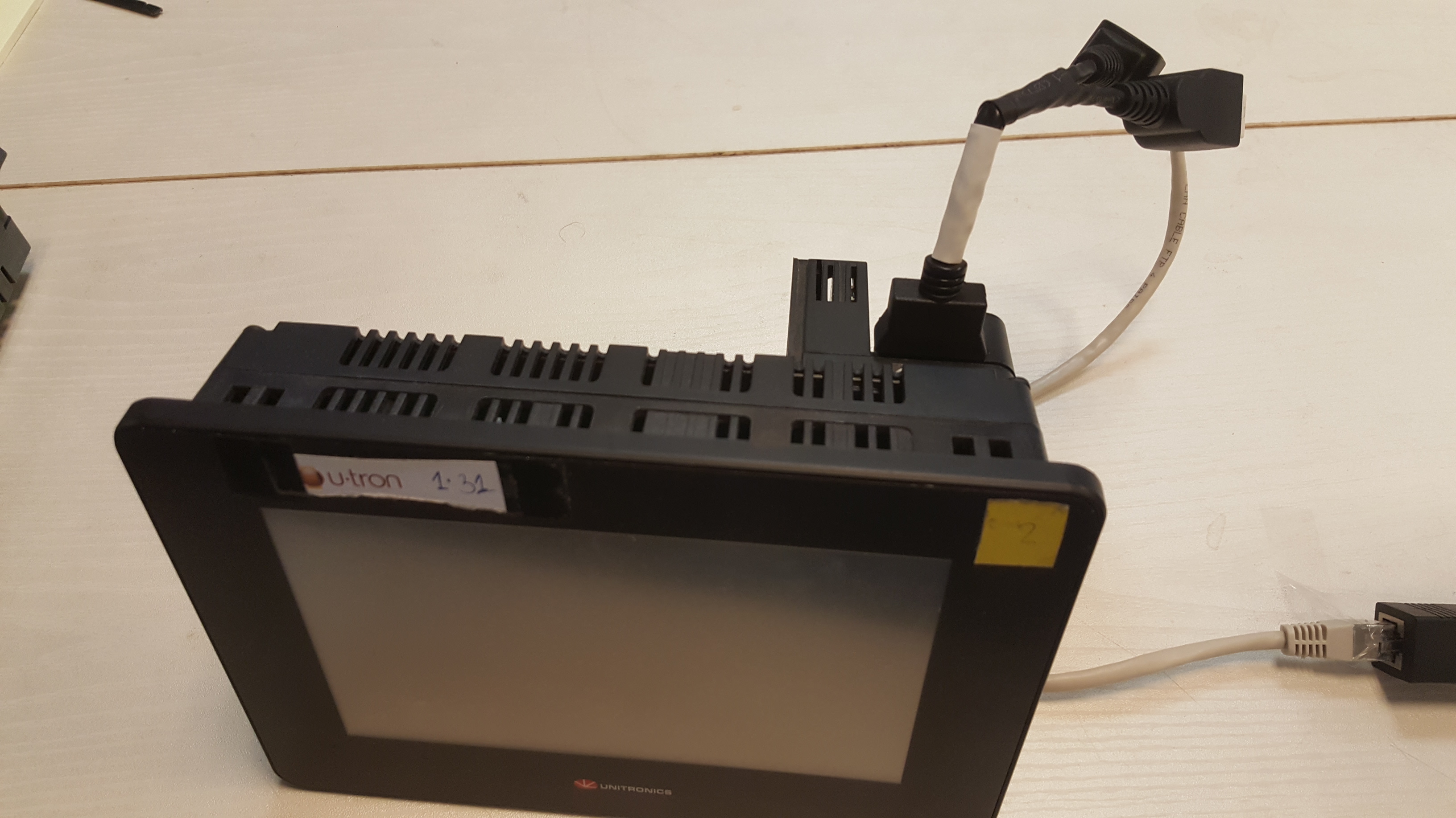

The Canbus Y cable will be connected to the PLC using the Canbus port.
On the second side the  resistor and a LAN cable will connected.

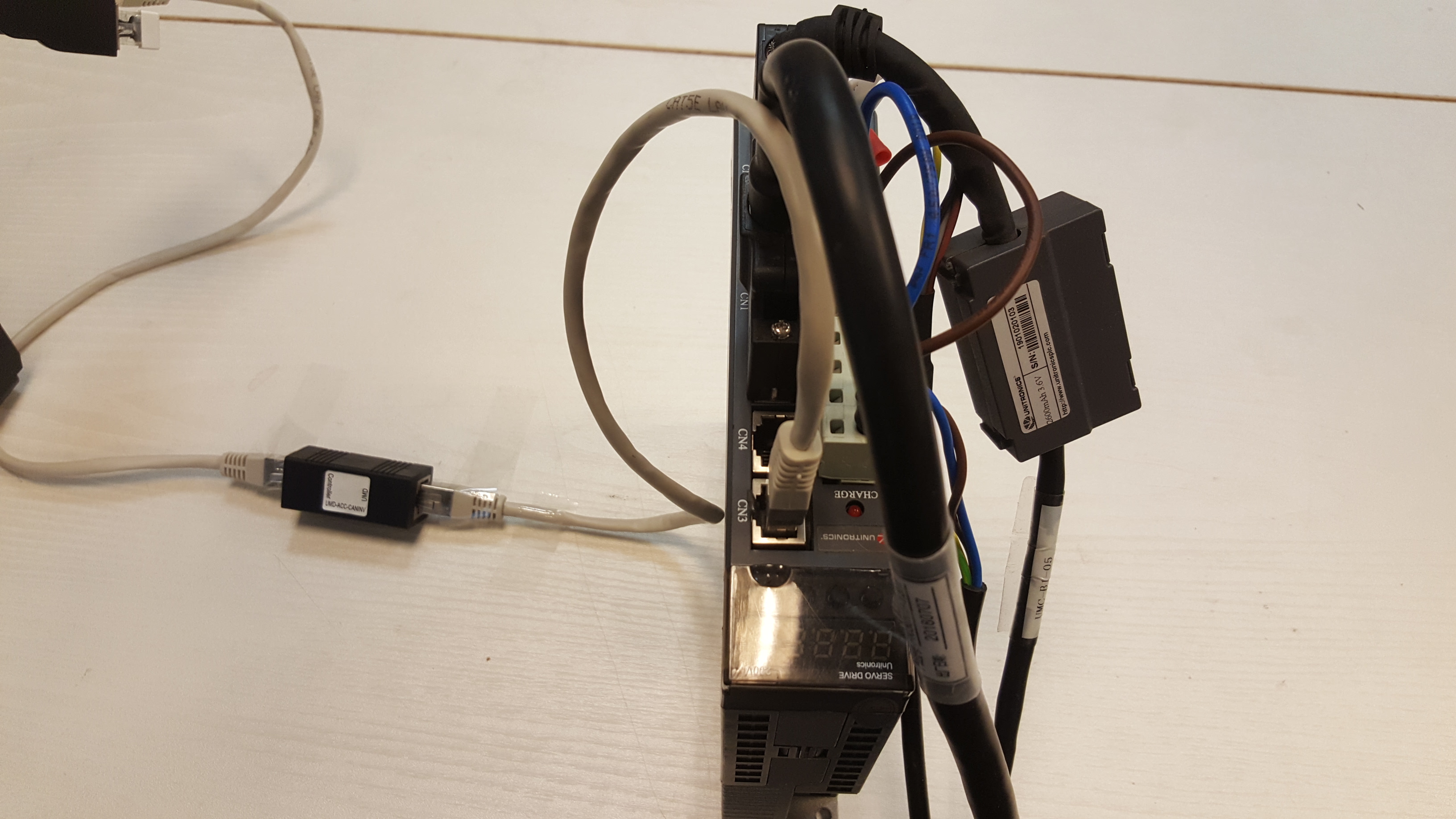

The LAN adapter has a label which indicates the correct way to connect between the Controller and the drive.
One side will be connect to the LAN cable coming from the Canbus Y cable and other side to the CN3 or CN4 Servo Drive  connection.
