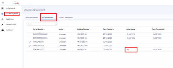

Disconnect PLC from your organization.

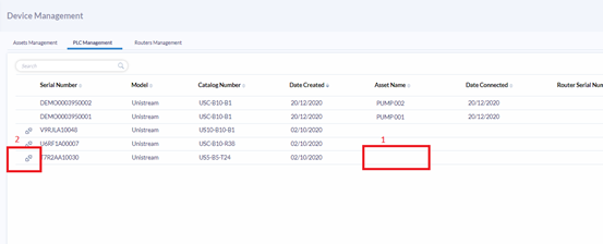

  • Open device management and select tab PLC management.
  • Locate the PLC serial number you wish to disconnect and click on the name of its asset.

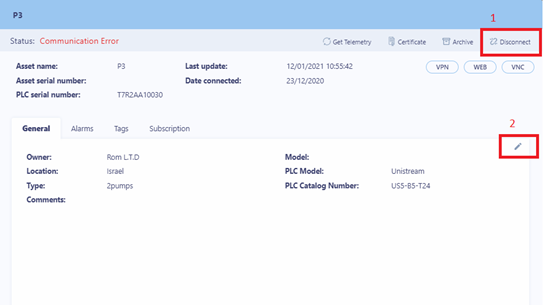

  1. Click on the disconnect option.

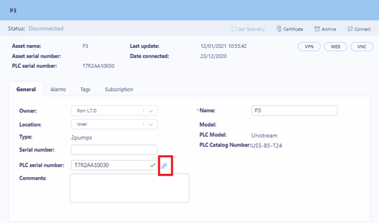

  2. Click on the edit icon.

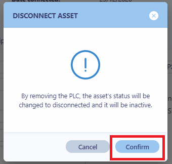

Click on the disconnect icon.

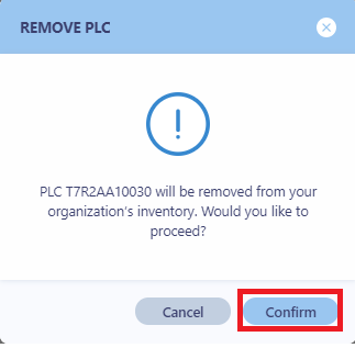

Click to confirm disconnecting the PLC.
After disconnecting the PLC from the asset , remove the PLC from the PLC management by pressing on the disconnect icon:

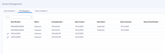

Now the PLC will be removed from the list
