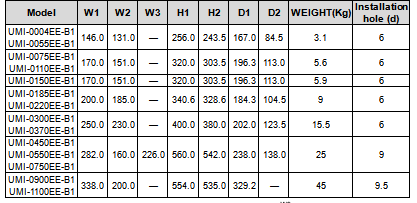

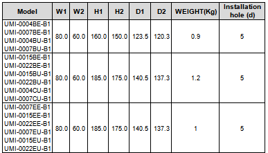

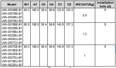

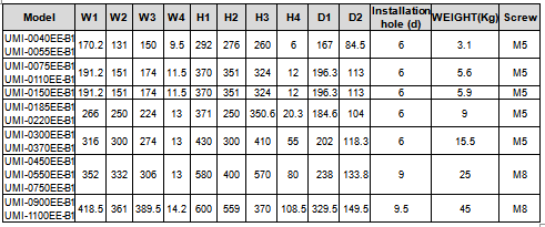

Wall mounting of inverters of UMI-B1 1PH-3PH 220V/3PH 400V (≤2.2kW) Dimension (unit: mm)
Rail mounting of inverters of UMI-B1 1PH-3PH 220V/3PH 400V (≤2.2kW) Dimension (unit: mm)
Wall mounting of UMI-B1 3PH 400V 4 – 37kW inverters
Wall mounting of UMI-B1 3PH 400V 45 – 75kW inverters
Wall mounting of UMI-B1 3PH 400V 90 – 110kW inverters (Dimension (unit: mm))
Flange mounting of UMI-B1 3PH 400V 4 – 75kW inverters
Flange mounting of UMI-B1 3PH 400V 90 – 110kW inverters (Dimension (unit: mm))
