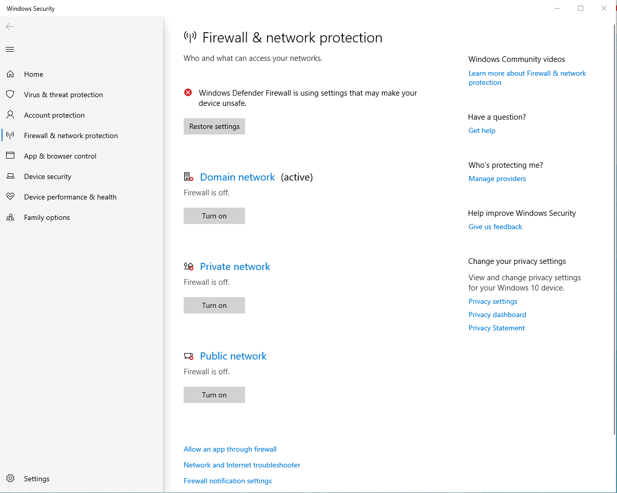

Turn off the PC`s FireWall.

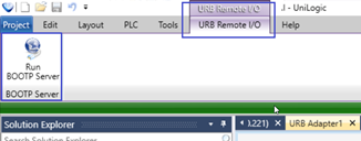

  • Open "BOOTP Server" software from UniLogic dynamic ribbon:

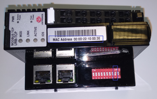

Make sure that dipswitch 9 in ON AND THE Ethernet cable is connected before the power cycle in order to the adaptor to be detected.
In order to detect the remote IO with the new IP, you MUST Power cycle the Remote IO once when dip-switch 9 is on, power off switch off the dip-switch9 and power on the URB.

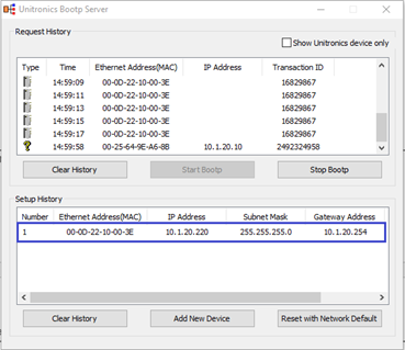

Press on "Start BOOTP"
You will see new connections being added, check your Adeptors MAC adress and doble click to select your addaptor.

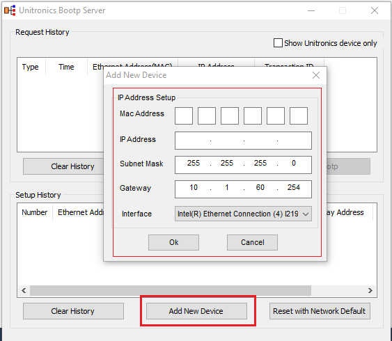

Set up your Adaptors  IP.
You can see that your new adapter has acquired your new IP.
Power off your Adapter and switch back dip switch 9 to OFF.

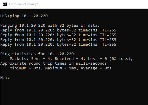

Open your terminal to verify communication with the Adapter.

Setting the URB IP with a different domain can be done via RUB MAC.:
