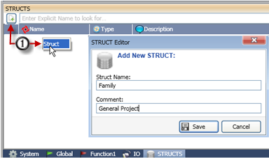

To create a User-defined struct please follow the next steps:
  1. Click the Struct tab on the bottom of the Operand Window.
  2. Either click the Add Struct icon, or right-click and select Add Struct.
  3. Name the Struct and click Save.
4. Either click the Add icon or right-click the window to add members to the Struct. You can add single operands or arrays)

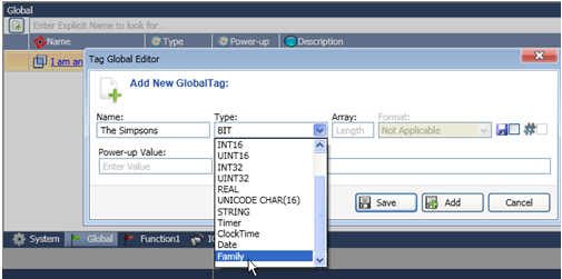

To use the struct on your project, you need to declare an instance.
You can declare an instance of a Struct either as a global tag, or a local tag.
  1. Right-click the Global Tag window, or the window of a function. Name the instance, then scroll down until you see the name of the desired Struct and select it.

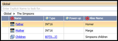

  2. Now that the Struct is declared, you can assign Alias names to the members.
  3. You can also drill down and assign Alias names to individual members within arrays that you have included in the Struct.
Now that the Struct has been declared, it can be used in your program just like any other tag.
