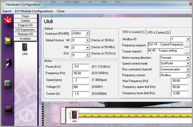

  1. In Hardware Configuration, select UMIs from the Hardware Element selection bar, and drag a VFD to the DIN rail; the Configuration window opens.
  2. Select the serial port that is to be connected to the VFD.
  3. Under Global, you can edit the start operands of the Global Vectors; these operand vectors are reserved for use in the VFD subroutines.
  4. Under Motor, enter the parameters of your specific motor model.
  5. Under VFD & Control (1), link operands for Frequency Request and Torque Request; you will use these in your program to control Frequency and Torque. Edit the values in VFD & Control (1) and VFD & Control (2) according to the parameters of your UMI model and application requirements. These parameters will be written to the data table created by VisiLogic, Configuration. Note that in this data table, VisiLogic adds a row to contain the data for each UMI you include in your application.
  1. 6.When you are done, click OK.

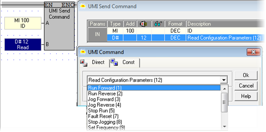

Sending Commands to the
1. On the Ladder toolbar, under the Utils menu, select UMI Send Command.
2. Select the Modbus ID of the desired VFD
3.Select the desired command
Command numbers
1
Run Forward
2
Run Reverse
3
Jog Forward
4
Jog Reverse
5
Stop Run
6
Reserve
7
Fault Reset
8
Stop Jogging
9
Set Frequency
10
Run Torque
11
Write Configuration Parameters
12
Read Configuration Parameters
13
Read Status

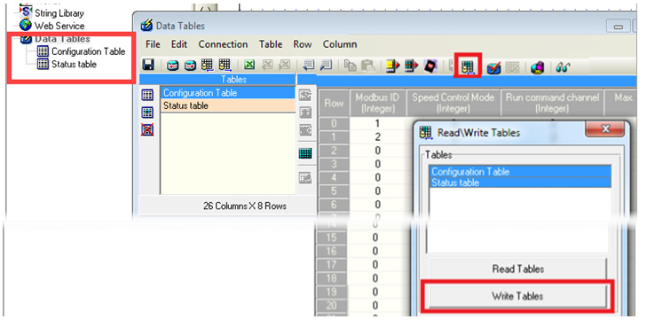

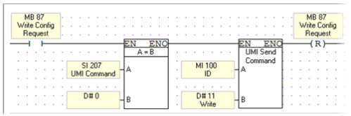

Configuring the VFD
After you download the application, you must write the parameter values in the Configuration and Status data tables, and then write them to the data tables in the PLC.
  1. In the Navigation Tree, Click Data Tables, then the Read Write icon.
  2. Select both table via CTRL + right-click, then select Write Tables.

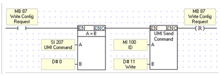

3.In your Ladder application, write the configuration parameters via UMI Command #11, Write Configuration Parameters, as shown in the rung below.
You can also read the parameters from a VFD into the Configuration data table, via command #12 Read Configuration Parameters.

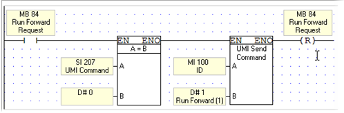

Controlling the VFD
You can send control commands to the VFD, such as Run Forward, Run Reverse, Stop, etc.
The rung below shows how to sends command 1 – Run Forward.

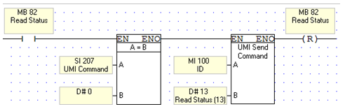

Reading Status:
You can read the UMI status using command 13.
The VFD statuses values will be written to data table "Status Table".

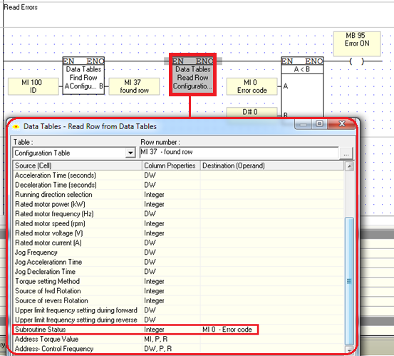

Checking Errors
In order to check whether a command was successfully executed or failed, you can read the column "Subroutine status" from the Configuration data table.
First find the MODBUS ID of the VFD in the data table and then read the subroutine status.
Note that each time a command is sent to the VFD, the data table column "Subroutine status" is updated).
If the value is negative then there is an error with the last command sent to the VFD.
