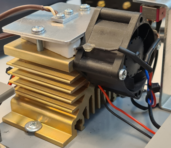

The temperature sensor is a thermocouple type T.

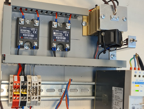

The heating component is two 24V DC heating elements on a steel plate attached to the heat sink
The cooling element is a 24V DC fan on the heat sink.

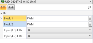

To implement dual PID, you will need temperature input and UID-0808THS to operate the PWM control of the heating-cooling devices.

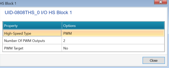

The user needs to configure the THS output Block to PWM.
Once you configure the THS, in the I/O there will be new integers for the PWM frequency and Duty cycle.
The frequency is given in milliHz units.
NOTE: the frequency you need to apply is depended on the physical components.
