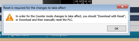

Changing Configuration:
Please note that when you change the configuration of the 0200E , you must reset the controller. You get a message box when you change the configuration:
Performing Download All will execute reset as well.

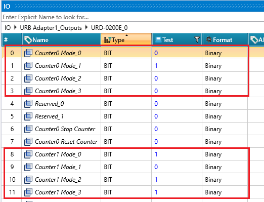

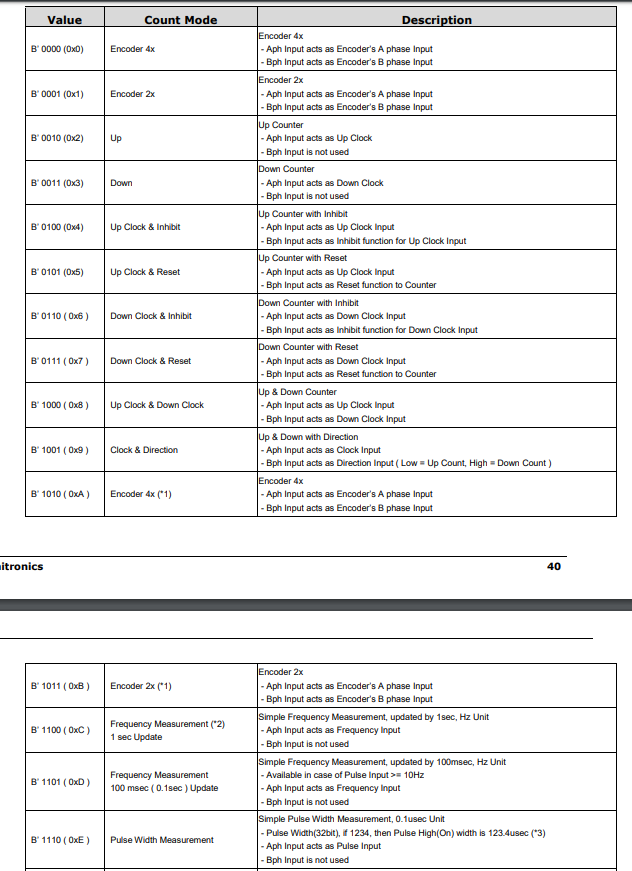

Please note that you can also change the counter mode while the PLC is running using the outputs array – just set the counters mode according to the bitmap captured also from spec:
